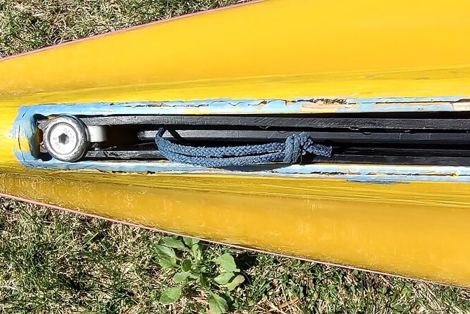

...Some earlier Kari-Tek plastic skeg boxes have come partially loose from there glass composite surrounding and started to leak.
These instructions are for fixing the leak and making the
